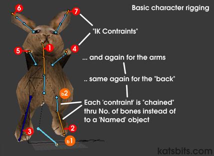

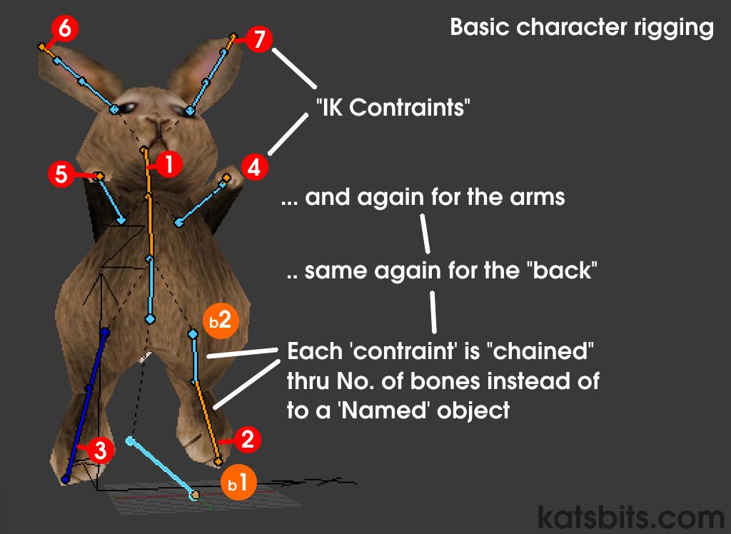

This is how 'Bunneh!' is rigged (granted a simple character but you get the point);
The orange coloured bones have IK Contraints attached, but instead of locking onto a name object (another bone) I just use the chain length setting only, usually for "2" bones in a chain. That pretty much locks the chain to an "arm", "leg" or other isolated unit.
So yes, to back up what mikshaw said, you shouldn't really be having any IK specific export problems just because you've assigned them to bones in the rig; typically problems are caused because of the way IK are used, not because they are being used.
