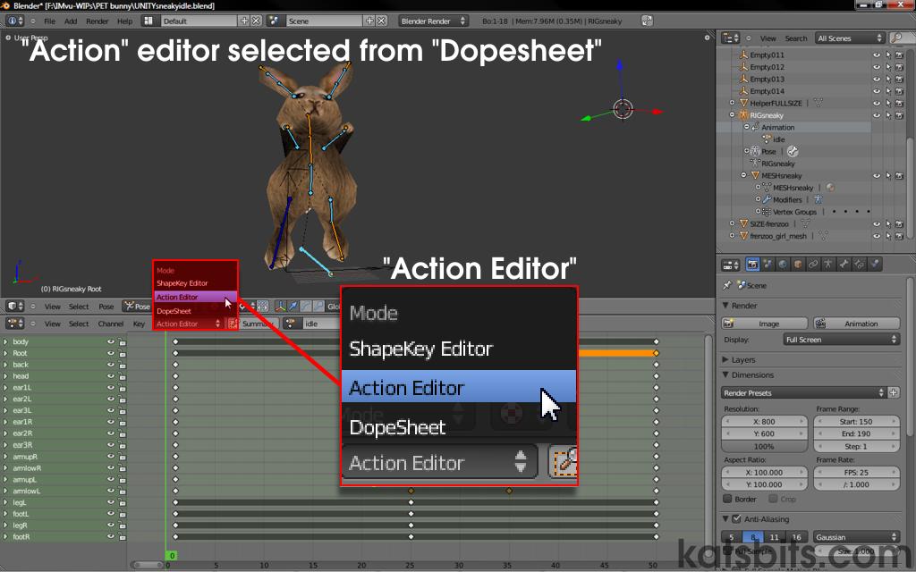

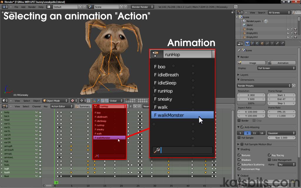

    • Posts: 3283
The engine you're exporting to or working with determines which animation process you use. There are basically two types or ways to animate.
  • 1) individual animations
  • 2) included or grouped animations
1) Most games work this way, meaning that you create separate animation tracks - 'run', 'walk' and so on - each of which is then exported out as a separate animation file, in this case you could have ten separate *.md5anim files and one *.md5mesh file.
2) Tech like Unity3D use this approach whereby all the animations are included into a single track which is exported out. In the engine you then set up the animations doing what you said - 1-99 = 'walk', 100-199 = 'run' and so on
Now with regards to the 'structure' they've changed that again. In previous versions you'd have the 'Armature' at the top and then the animations as a child connections;
  • Armature
  • >> animation 1
  • >> animation 2
  • >> animation 3
But they appear to have changed that so in the OOPS/Outliner view its now listing animations only on being actively selected like this;
  • Armature
  • >> animation 1
And again if a different action/animation is active;
  • Armature
  • >> animation 2
That's bound to change the internal data structure but at the same time it does mean that Blender is dealing with only the data that selected/active?
You can change the name of animations in the OOPS/Outline be Ctrl+LMB clicking the name to active 'edit' mode on that, you can only change user generated data though and not 'core' data - "Animation" as a named datablock can't be changed.
For the other stuff you mentioned, the "Action" editor is now a sub-editor of the main "Dopesheet" editor, so you have to go into Dopesheet and select "Action" from the dropdown menu in the header. Once there you can do all the usual edit/delete/new functions previously available.

1) you dont mention NLA Tracks at all; useful? ignore them?
2) if not NLA tracks, then actions are basically floating in memory and only the "active" one is really visible at any one time, so I wouldn't be able to export more than one action at a time it seems?
Aside: Blender seems to have a couple of places (this, and texture image links come to mind) where stuff can be created and just floats around in memory unless its also attached to something, which bugs the carp out of me. Stupid myTexture.001, myTexture.002 IDs that I don't know exist and cant get rid off once I do. In my mind, EVERYTHING data wise should be accessible from the Outliner tree.
