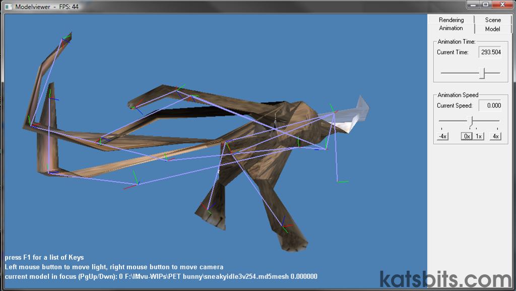

It seems to output a file in the correct format, however running the file shows the bone matrix values are corrupted. My frog character looks like a twisted mess.

Mesh exports OK.. no UVW issues from what I could tell. Will try other characters when I get a chance. Animations mess up quite bad as per your experiences, the bones seem to export OK as the rig looks sound without an animation loaded (into the MD5 viewer again). Loading in the *.md5anim 'breaks' the rig and splats the model all over the place.

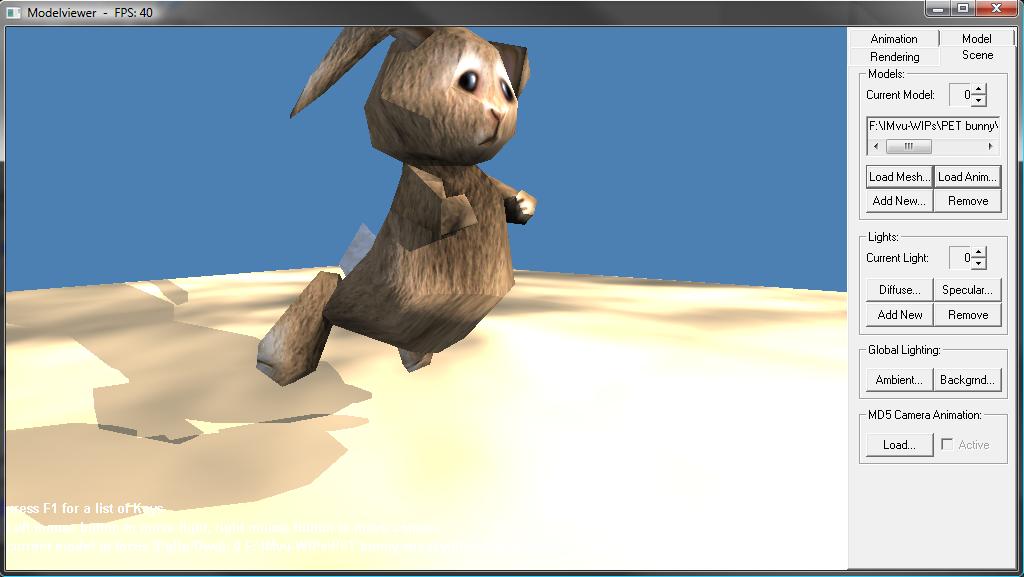

Yay, squishbunny is squishy. Also, didn't I _just_ learn that matrix multiplication order got flipped in Blender 2.5?? Durrrr...
Problem solved, correct script is available at ( http://dl.dropbox.com/u/1556553/io_export_md5.9-17-2010.py ) pending rigorous testing.

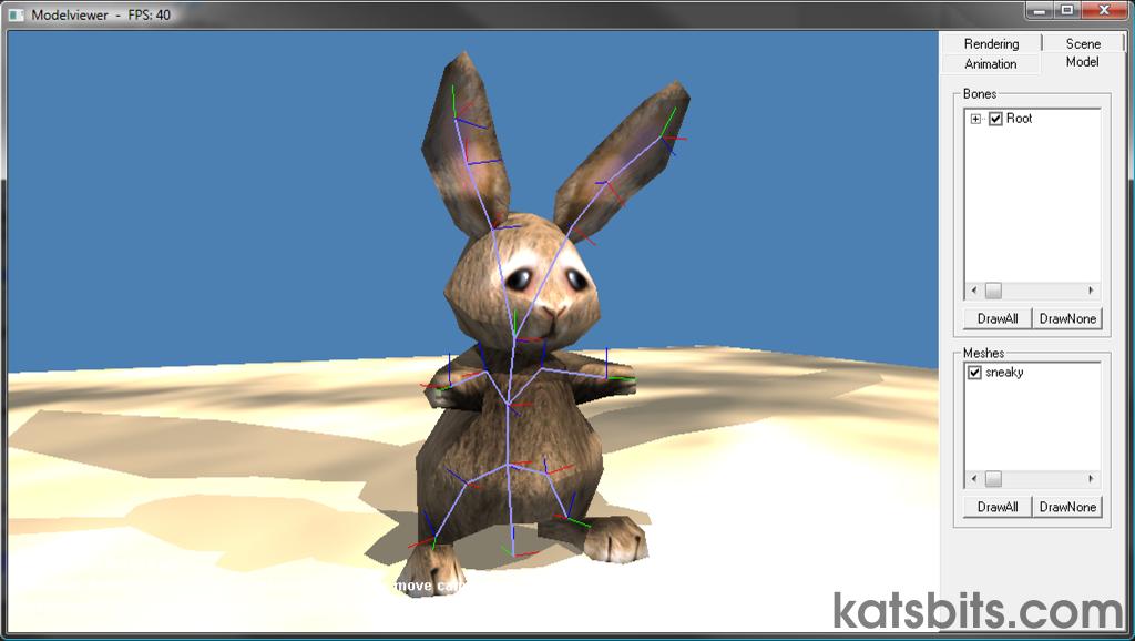

BTW; I know bunny is somewhat low poly, but is he supposed to be that faceted, or am I exporting the normals incorrectly?
Ah yes, everything is fine, that's just the dynamic shadow volumes of the MD5 viewer doing that, the volumes don't 'blend' or 'soften' over edges (which you probably know already), so the edge of the volume tends to be hard, causing the wierd visuals - character models in idtech games generally have 'self-shadow' turned aff because of this problem.

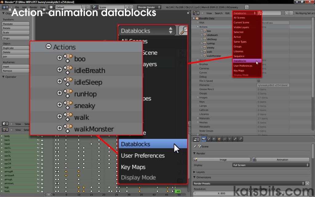

They've moved datablock access again. In the Outliner view click the dropdown list and select "Datablocks", actions are listed in that view under "Actions" - it should be expandable with any animation Action present in the file being listed there. So the data is there, I've just no idea how you get at it to do export all of it in one go  :-\
keless
Hrm, I thought I'd looked at that Datablocks mode of the Outliner-- guess I missed it. In my frog sample I can see the "rock" animation and the "action" (default that I though I threw away) in the data blocks. Interestingly it seems its the "action" action that has the rocking out keyframes in it, and the "rock" action is empty >.<
In python I can access it from bpy.data.actions['actionName'] so I can definitely iterate over all the actions. But in order to pull the actual animation data from it, I need a way to bind that action to the armature as the active action...
Looks like setting theArmatureObject.animation_data.action = bpy.data.actions['ActionName'] may work.
