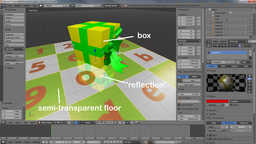

Basic scene in Blender (in GLSL so Material transparency can be seen) showing a semi-transparent floor between a giftbox that's duplicated and flipped upside-down (Alt+M to Mirror, then ยป Z) to create the 'reflection' (remember to use Apply and then Flip Direction to fix the mesh appearing inside-out after being flipped upside down).

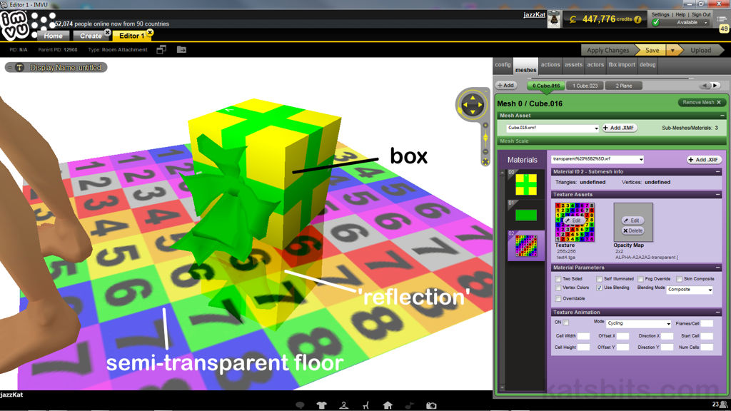

In IMVU the Blender scene is automatically imported and assembled as three objects (exported as separate objects to the same FBX file from Blender) with three materials, the TRANSPARENT one (shown using IMVU's default 'can't find the image' texture) is important here as it has a 2x2 auto-generated mid-grey image that makes the floor appear semi-transparent based on the grey value.
Incidentally, did you know you can export Material-based transparency to FBX and IMVU will automatically generate the appropriate grey-scale image it needs to make the resulting material in IMVU match the value used in Blender? Make sure to set up the scene and objects as instructed here for this to work properly.
Watch the following to see how to set up a transparent Material (no texture/no image) in Blender (shown) that can then be exported and converted on import to IMVU (not shown, see above).
