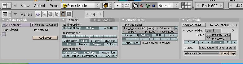

settings
These are my child/target settings....

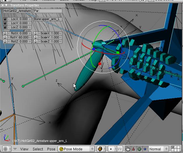

side
Arms sticking out to the side, the discs are rotating properly here,

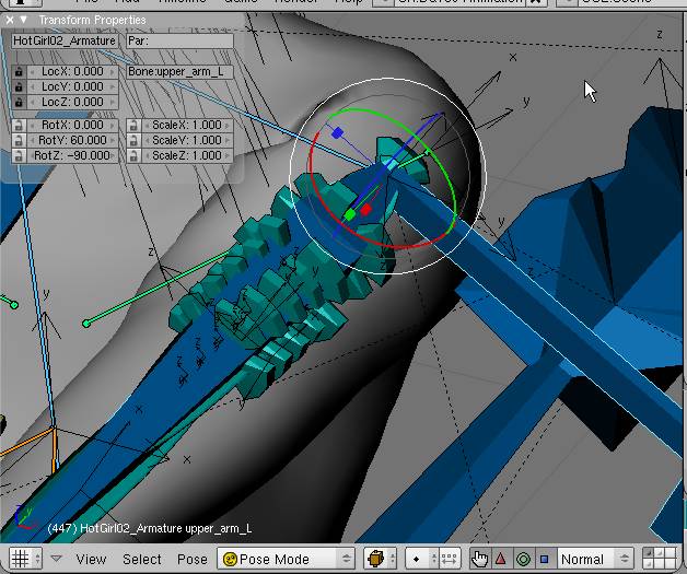

fwd
....and they are rotating properly when sticking forwards as well....

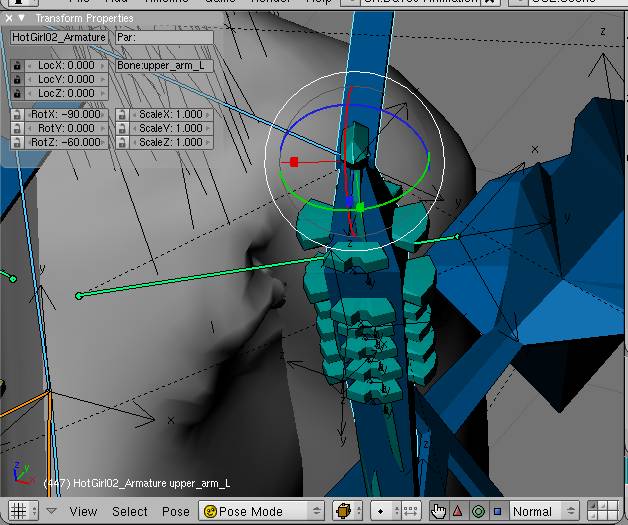

down
....but when they hang downwards, the discs ignore the copy rotation constraints, and for some reason, the X,Y,Z numbers in the corner flip. They only do it for this set of bones (and the matching ones on the right side as well), the rest of the sets work fine in ALL 3 DIRECTIONS!
