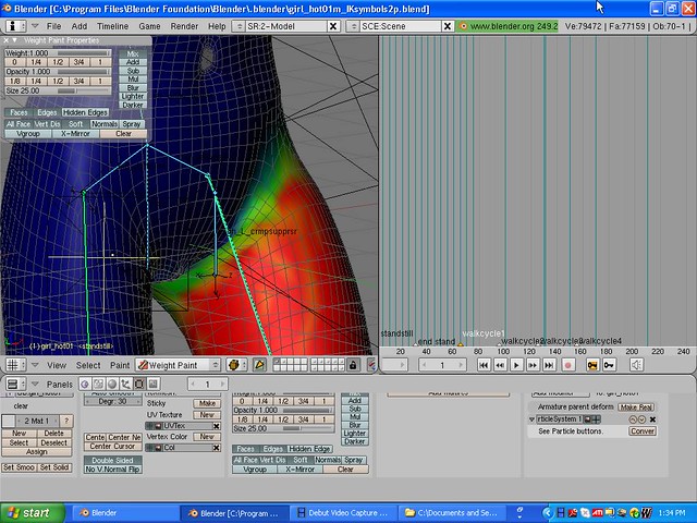

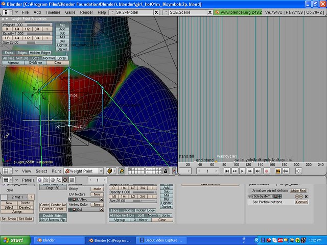

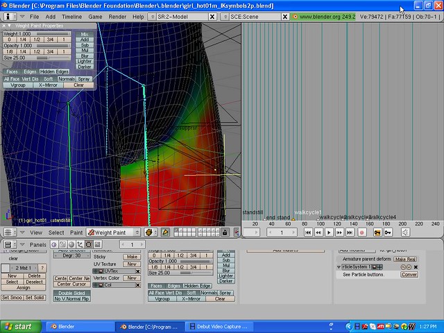

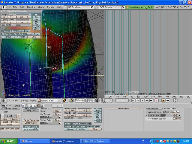

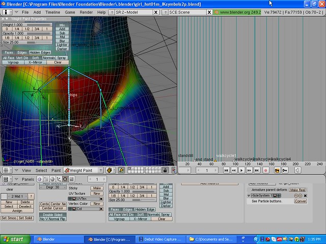

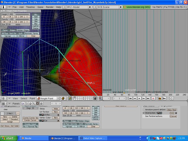

- default position, with both influences highlighted....
- low angle of bend....
- more severe bend angle, notice how the trench forms as the vertices
get driven into the opposing sides of the bend surface. I can't seem
to eliminate this trend as the angle gets sharper. I was hoping Blender
might have a setting that changes the way it handles the cross
interpolations (or whatever it might be called) and save me from having
to create & tune dozens of intermediate control bones....
