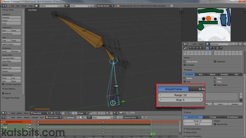

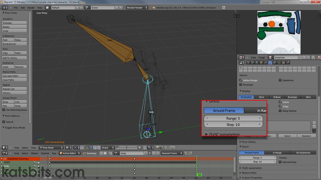

They basically just change the way the ghosting is displayed on screen, depending on what value you use you'll seem more or less 'ghosts' and or 'divisions' (increments) between each level of ghosting. The difference can be relatively subtle though (see below). The effect only appears to be active when in "Pose" mode (which is a shame), and only on the armature from what I can tell (which is an additional shame).
Ghosting with "Range: 10", "Steps: 5"
Ghosting with "Range: 5", "Steps: 10"
thanks kat, and i think i've learnt to read the ghost images now, they seem to leave trails of different lengths, depending on the range values, and the steps are, as you say, the increments between the ghosts. it's a shame the 'on keyframes' isn't more readable but i think these tools will help me fine tune my animations when needed.
