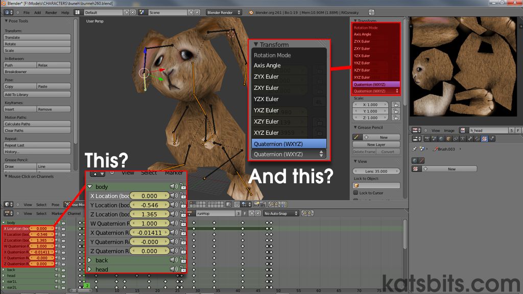

Are you talking about the below Ratty ("body" bone expanded in the Action Editor to show the various animation data 'channels' available)?
If you are, then in the broader sense, whether you use that way of manipulating a Rig is going to depend really on preference rather than necessity - how do you 'prefer' to manipulate/create an animation? I don't think I've ever used those channels to actually manipulate a character for example (I've used them to check the resulting data but never used them to animate), everything I've ever done is based on manipulating the bones rather than the data that generates. From what I've seen in the community at large, doing it that way seems to be an exception rather than the rule though :-\

I'm not sure you need to 'convert' them like that Ratty. If you look in the screenshot above, the main Transform/View Properties drop-down lists the different types of "Transform" that can be used, depending on which one you select it switches/updates the current sequence data to use that selected positional subset. These can also be set from "Object" Properties under "Rotation Mode:".
