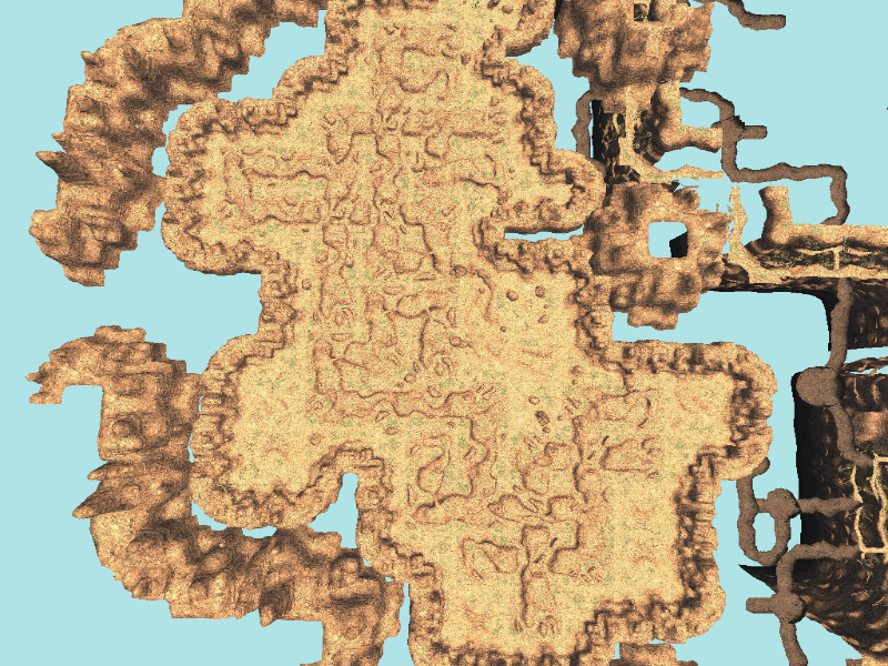

Just to illustrate the effect I'm going for, if you're familiar with Final Fantasy XI, their area maps are all built out of tiles. Unlike the trainwreck that is FFXIV however ("copy pasta'd terrain", etc), they actually did a great job with it in XI.
Here's a couple good shots to show you how a couple zones look from above. If you look closely, you can see some of the repetition. SE did a great job with the tiling in this game; everything is homogeneous enough that very, very little "jumps out" at you as being repeated... and even then, you have to be looking for it.
First is of a zone called Buburimu Peninsula (this is a map used by a guild for a raid-like event in game, hence all the lines, etc)
And another from part of Attohwa Chasm. You can really see how tiling was used in this shot.
What's interesting is that, at ground level, you really can't tell you're in a tiled environment, everything is so well put together.
Again... I really don't know what the hell they were thinking with FFXIV or how anyone at SE let that go as-is.
