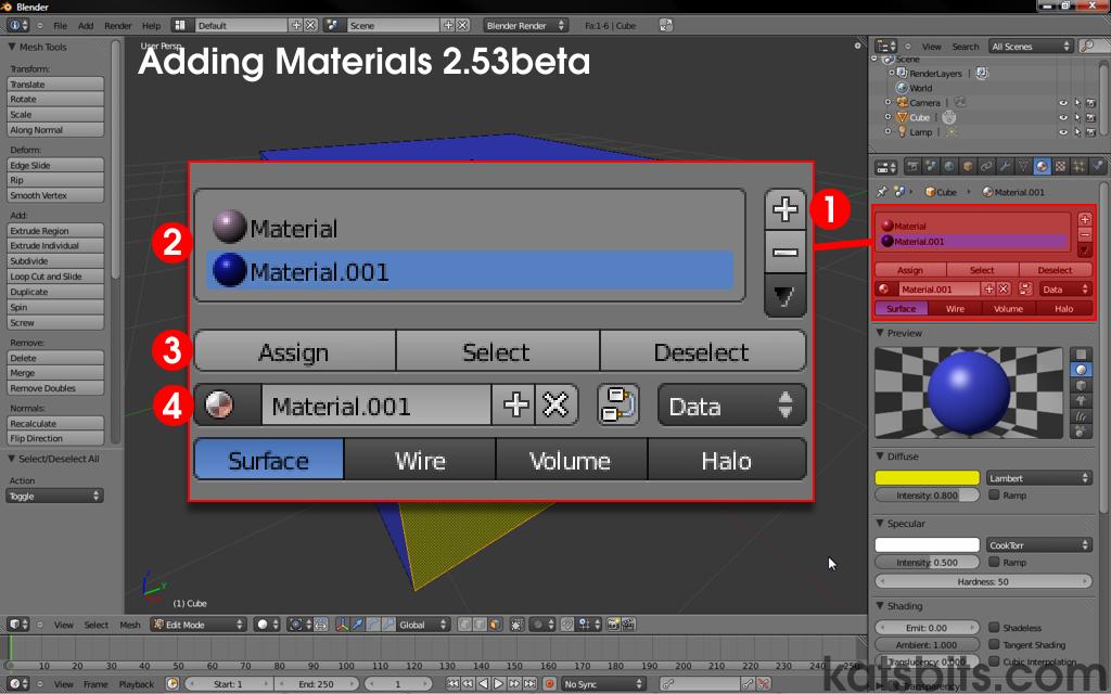

Up to 2.57b if you already had a material assigned to a mesh and clicked the "+" (add new material) button to the right of the material list[1] it creates a new entry, a duplicated of the original - in the material list you'd see two identical materials[2] (in the shot below the material is show after it's been made 'unique' - if you click either one they'd both show exactly the same settings). To make this new material independent of the parent (so it could be assigned to a specific section of the mesh) you'd simply click the "+" to the right of to the materials "DataBlock" field[4] (where the name can be changed), 'converting' it into a 'unique' datablock that can then be assigned to selected elements.
Shown above. When the "+" button is clicked[1] it creates a duplicate of the original material that can then be made 'unique' and renamed by clicking the "+" button to the right of the datablock name[4]

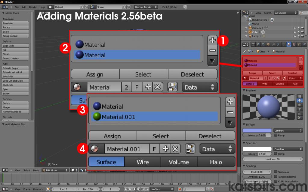

Shown above. The same behaviour is also true in 2.56beta where a similar process is gone through; the material is 'duplicated ('new')[1,2 & 3] and then made unique[4]

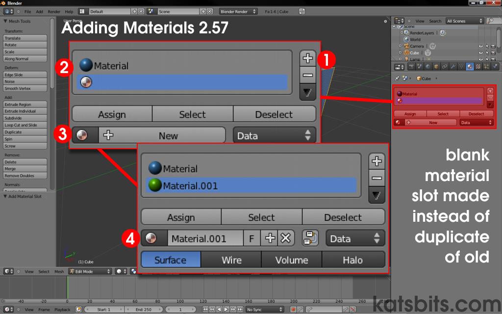

In Blender 2.57 this has changed. When you click the "new" button now it creates a completely blank datablock that has no relation to the previous material, it's effectively 'unique' by proxy (because it contains no data). The fact that it's neither a duplication nor fully 'tooled up' (with some default settings) can be seen as both a 'Pro' and a 'Con' - a 'Con' especially where materials are used not just for just for 'texturing' but also for mesh organisation, different materials can be applied to different areas despite referencing the same texture/image data and so on. To create duplicates in 2.57 you now need to select the previous materials 'data' from the datablock list[4] (click the sphere icon to show the list and select the material). This retains the unique nature of the new material but assigns the 'parents' properties. In effect, adding new materials is a sort of reveral of the previous process, you create the new as a unique then assign properties as opposed to create a new material with the same properties then make that unique.

Creating a new material in 2.57 simply adds a blank 'unique' slot that can be edited as is or assigned settings from another material
