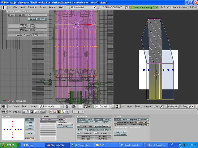

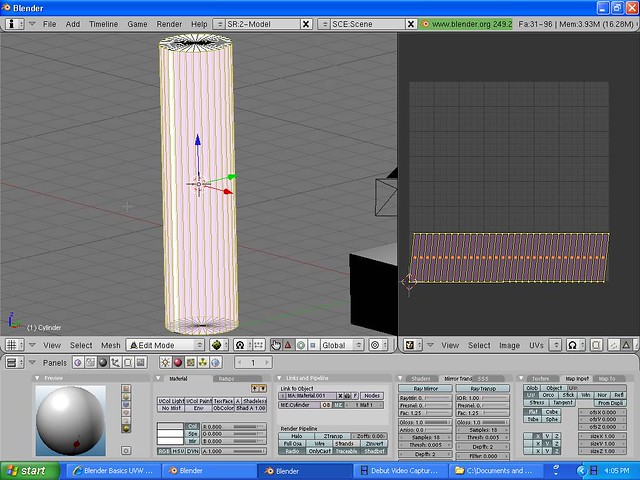

here are two cylinder unwraps from side and top plan views....
-side-
-top-

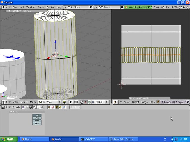

Make sure your cylinder is seam marked similar to the following;
This usually happens for a couple of reasons (that are easy to fix).
  • 1) resizing or manipulating the object - in this instance Blender is basically still referencing the original shape/size of the object when the unwrap is performed, so naturally it deforms because it no longer represents the actual shape/size of the object.
This is fixed by using "Apply Object" on the object before unwrapping - select object (you need to be in "Object Mode" for this (toggle edit) and press "Ctrl+A" to open the pop-up menu, select "Scale and Rotation to ObData"
  • 2) using the wrong "Unwrap Method" - Blender can basically unwrap objects in two ways, 'relative' and 'absolute'. Relative uses "Angle Based" calculations, absolute forces Blender to use a "Conformal" calculation that 'conforms' to the objects shape.
This is fixed in Edit Mode by setting "UV Calculation" to "Conformal" instead of "Angle Based" (you may still need to use "Apply Object" to get this to work correctly). See below.
Using "Angle Based" tends to distort certain shapes
"Conformal" is much better for 'man-made' shapes that have hard contours and silhouettes
Additionally, if you find that you do need to manipulate the UVW map in the UV/Image Editor, turn on "Snap to Pixels" (this wasn't mentioned in the UVW tutorial on purpose by the way).
(you should be able to see an example file attached below)
