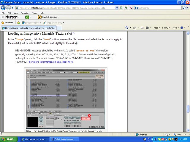

I'm following the tutorial, but when it gets to << Part 4: texturing >>, I get to "Loading an Image into a Materials Texture slot" and when I try to select the image, as directed, I don't get the same results that the tutorial shows anymore. There is no image list to select from apparently, not even a "generic4.tga" file like the tutorial shows. I am now stuck dead in the water. How can I continue?

I was following the tutorial literally page by page, but when I get to the section about loading images, this is what the tutorial shows I should get....

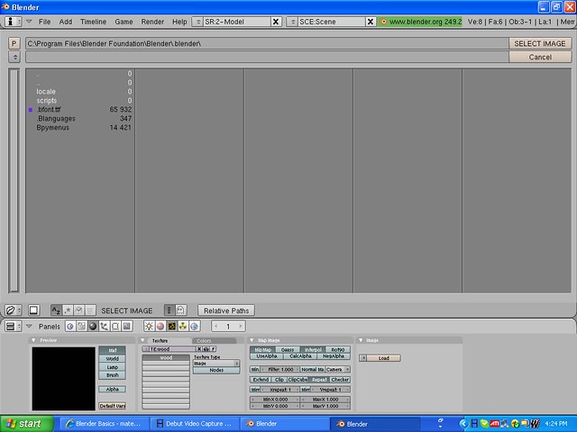

but this is what I actually get....
The tutorial mentions nothing else about if I have to make, or obtain and install these images or textures ahead of time, from somewhere else - only to do this, and then this, and then select what will come up.... Well, nothing seems to come up.
Remember, I am not a Blender user, so I don't know the things that others here will already know and take for granted for knowing. I've poked around the local directories and don't see the list that is appearently shown in the tutorial picture.

With regards the second problem. I'm adjusting the tutorial at that point but for the sake or replying here.. yes  you won't see that because that's my PC ;)  Download the sample file and then open the various *.blends it contains. When you come to 'load' the image file, the browser should open in the same folder the *.blend file was loaded in from.
Otherwise yes when you have the file browser open as you've shown, click the double headed arrow on the left (under the button marked "P"), select a letter for a corresponding hard-drive to view it's containing folders. White text are folders, single click those to drill down into them and reveal their contents. Blue icons with black text names are images. To go back *up* the directories and folders, click the ".." at the top of the list. Blender does use the same metaphors as Windows to explore files, it's just that the 'icons' that represent those same actions are different.
