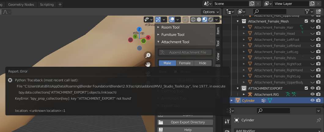

Problem
On exporting an accessory (attachment) or other type of product (clothing, poses, animation etc.) made using IMVU Studio Toolkit export fails and the following or similar error is shown (system path to IMVU_Studio_Toolkit.py may vary from shown);
Code: [Select]
Python: Tracback (most recent call last):
File "/[path]/[to]/Blender/3.2/scripts/addons/IMVU_Studio_Toolkit.py", line 1977, in execute bpy.data.collections['ATTACHMENT_EXPORT'].objects.link(each)
KeyError: 'bpy_prop_collection[key]: key "ATTACHMENT_EXPORT" not found'
Quote
Design note: depending on what's being exported the error may reference ANIMATION_EXPORT or other *_EXPORT key.

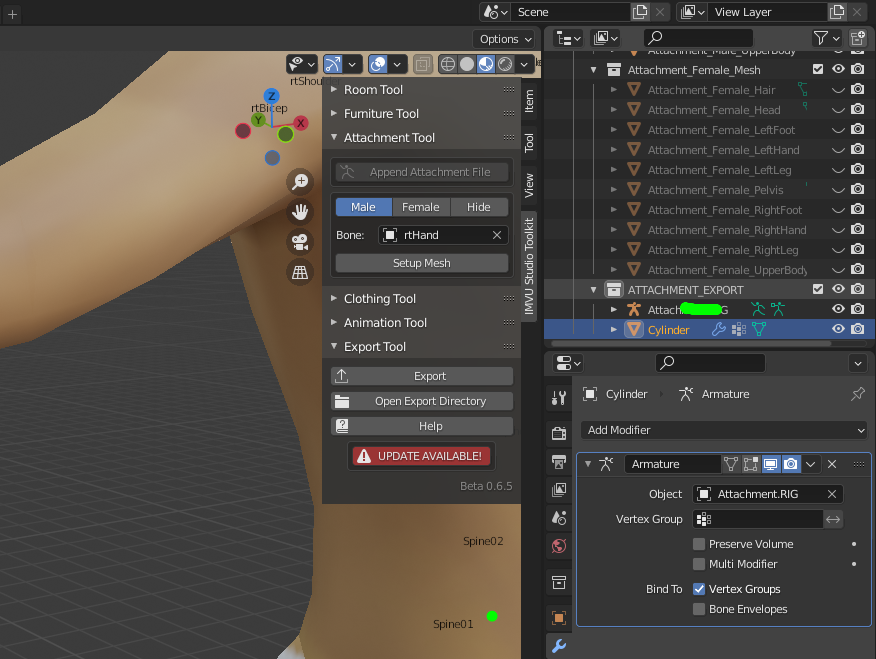

Solution
In the Outliner scroll down to the bottom of the list and make sure the ATTACHMENT collection is correctly name, it should be interspersed with an UNDERSCORE (_) instead of a PERIOD (.), i.e. it should be;
Code: [Select]
ATTACHMENT_EXPORT
not
Code: [Select]
ATTACHMENT.EXPORT
Double-click the collection label and swap the period for an underscore. This may need to be done for all projects built using pre 0.6.4 versions of the toolkit.
