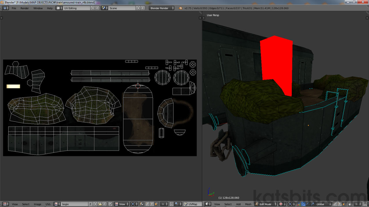

nice work, although when i first tried to look at the screencap a few days ago, my laptop was displaying the carriages as almost black due to so much sun light in my room. now i'm viewing them under better lighting conditions i can make out the details.
is there a work around you could use for dark textures like this during development? i remember some of my doom 3 rock textures were very dark, so i overlaid patterns or uv markers to help align them etc, then removed the overlays for the final versions.
No workarounds other than pretty much what you mention, UV's are mapped using checkers then baked and used as an overlay guide for texture making, otherwise can't see a blinking thing during the day!

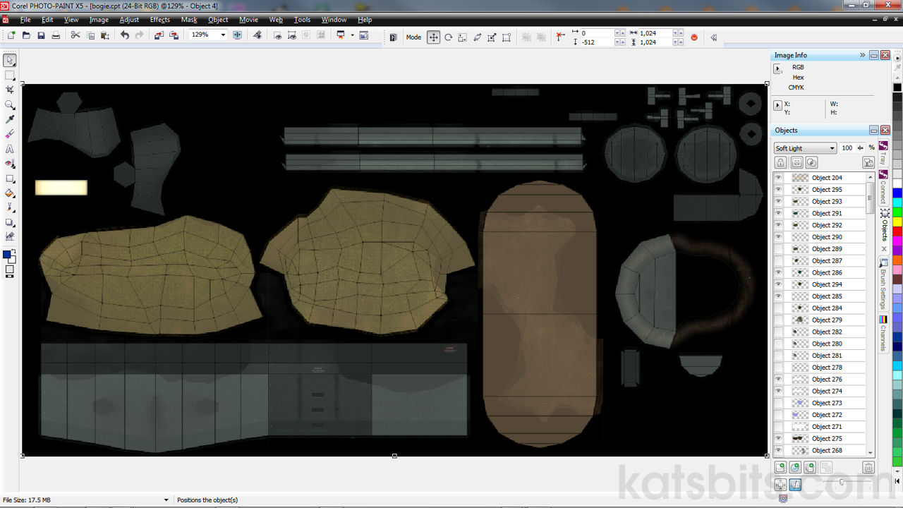

Texture flat open in Corel PhotoPaint with the exported UV over the top (which Blender can thankfully export semi transparent). And then shown using Blenders UV Editing with texture assigned.

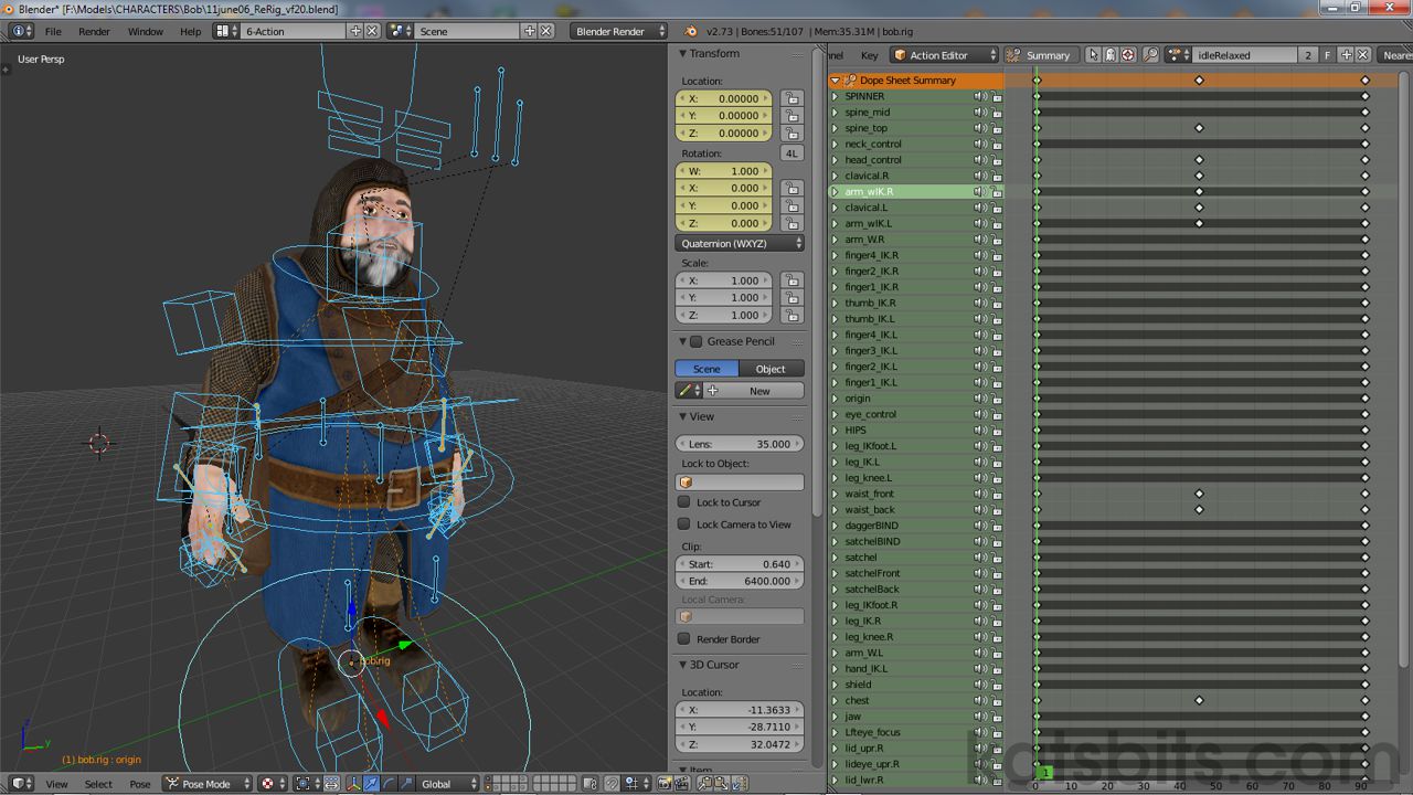

Working on updating Bob relative to idtech 4 specs (this is technically the third version/update to the character). Using bone shapes is interesting but do not necessarily make the animation process easier.

This iteration is still rigged relative to idtech 4, if it were for Unity it would be rigged in a different way (same overall structure but some of the master joints that enable AF ragdoll would be removed).
