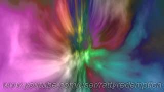

the first image below is one of the node material setups.

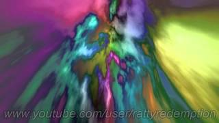

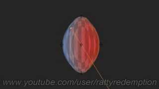

the next two images show one of the background meshes at different times during the animation, as well as it's deformation rig and camera. the node material is different for the last image.

below is a couple of images of my latest background deformation and camera key framing.
they might not look much technically, but in my opinion, one of the most interesting effects comes from how they combine with the node materials to produce some beautiful distortions, which in turn influence the movement of color, as it flows across the video frames.

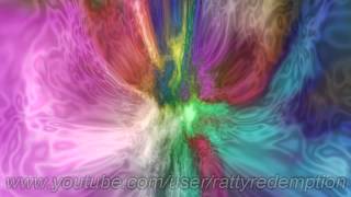

a test showing compositing of one of my pre-rendered psy cloud backgrounds run though a displace node, and then mixed with my pre-rendered high frequency pattern.
this node setup should allow me to use the same high frequency layer on any of my existing backgrounds which use the same mesh deformation and camera angles.

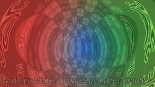

a test render without the medium frequency rotating layer, and with more variation in scaling.

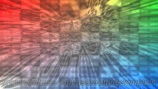

further testing of the displacement nodes, and mixing of my high frequency layer with my uv test pattern.
a test render with the high frequency layer blended more subtly with the psy clouds than some of the previous versions.
mostly the same as the previous test but with a different colored psy cloud layer. the high frequency is blended using an overlay mixer node so derives some of it's color from the background.
    • Posts: 3237
Noise level of the texture is a little higher than I'd use myself but overall you'd be hard pushed to know that was being done in Blender  ;)
do you mean the relatively small size of the gaps between the high frequency pattern? or the overall amount of movement that layer creates? and he he, thanks kat.
