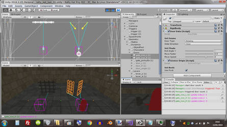

i also wrote a gizmos script for doors. which detects the door type, ie rotating or sliding, and draws either a little yellow pivot for rotating doors, or a sliding direction vector for sliding doors. the latter can move up, down, left, right, forward or backwards.
we can also enter into the inspector the door's move speed.
these two images show the pairs of trigger volumes and levers for opening some doors.
note the 2nd image has unity's "scene window > gizmos menu > 3d icons" turned off. which makes it easier to see the gizmos we're working with in the foreground, but also clutters the screen with gizmos scripts attached to objects in the background. we can disable those objects and or their scripts if need be.

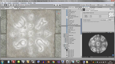

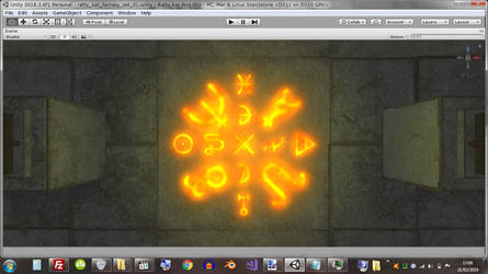

i've recently been experimenting with making some spawn/teleport textures. using the free image editor paint.net.
it's no where near as powerful as what kat uses, although it's ok for blending layers together and exporting jpg and png files. the sigils were copied from a free font called "inquit". that i downloaded from fontm.com. i'll be including my textures, unity materials and prefabs in my unity package for use with kat's assets, when it's ready.

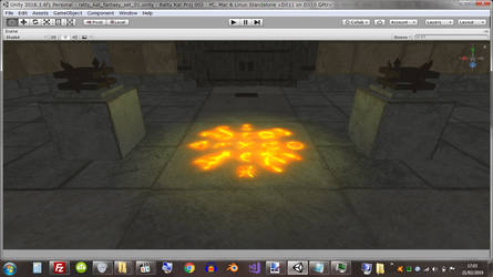

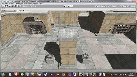

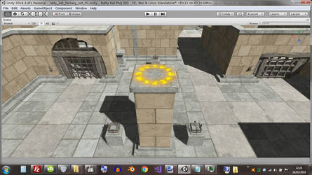

i've been doing some performance tests with the prefab spawners and their light objects.
considering i'm still using an old low end laptop, the performance of unity's standard material shader, using both alpha and additive blending seems pretty decent.
1st image has no light objects, only ambient lighting in the room. this is the fastest out of the 3 tests.
2nd image has a light object for each spawner decal. resulting in a lot of overlapping lights, which heavily impacts performance.
3rd has only 4 light objects, none of which overlap, and frame rate is good.
