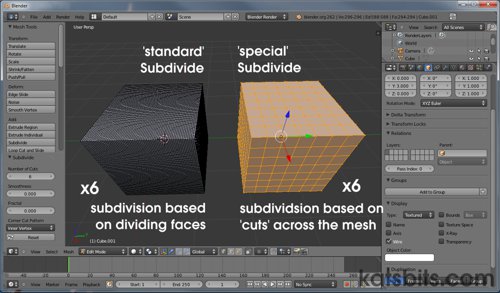

Simple vs 'special' subdivision
« Reply #6 on: April 23, 2012, 11:13:32 pm »
Comment from YouTube mentioned using 'Subdivide' properties when creating the mesh. This can be used but it must be noted that it doesn't divide the mesh in the same way as 'simple' (or 'standard') subdivision - the difference equates to standard Subdivision dividing faces rather than adding 'cuts' in the mesh as illustrated below. This simply means using higher values for the latter to get an appropriate level of mesh division.
Note however that using "Subdivide" properties limits the "Number of Cuts" to "10" by default so the property may need to be re-applied to gain a denser mesh - which then means any subsequent subdivisions divide and already divided mesh, which typically over-divides without a way to easily reduce the count.
Standard Subdivision is preferred then, as it's easier and quicker, it also divides using 'power of two' so it tends to match pixel distribution better (read that as "without the user thinking about it").
