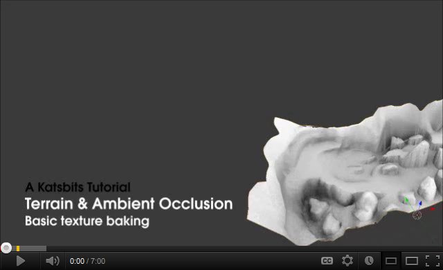

Video to accompany the updated
baking ambient occlusion maps for terrain
tutorial. This new version covers the basics of using the current versions of Blender to bake texture maps, 'ambient occlusion' in this instance.
YouTube -
http://www.youtube.com/watch?v=5jiVWv_ISqM

Is there a way to set the quality of the AO texture ?

Not as a specific setting no, 'quality' is directly related to the size of any texture being used and/or the UVW map relative to images associated with it. It's discussed in depth in the "
Terrain & Texture Density
" section of the written tute. Basically you need to use large images (subject to any limits your game engine or tech might have), and/or split the UVW's up in such a way as to increase the 'density' - the ratio between 'image' and 'UVW' map.
[EDIT] the rendering sub-system used for baking currently doesn't use Anti-Aliasing either by the way, so you can't use any of those settings in Render Properties.
